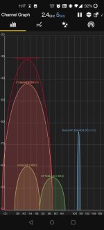

I would start off with an app to measure wifi signals in and around your place though to figure out what kind of interference you might run into from neighbors. Acrylic has an app for your laptop but on your phone any wifi analyzer app will work to measure things.
Pick your channel manually to get the best performance instead of letting things automatically configure as everyone else is doing the same because they don't know better. From the photos I picked channel 8 on 2.4 and 44 on 5ghz based on the surrounding WIFI systems and you can see the signal is stronger than when it would be contending with the default channels 5ghz = channel 36 and 2.4 = 1 / 6 / 11.
