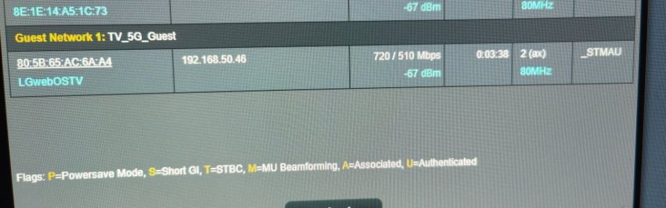

I have the same problem on a G2 for half a year and it is getting exhausting. The only times it seems to work better is when I connect it to a guest network created specifically for TV.
I was recommended by LG for the test to create a hotspot from another phone and to connect the TV and personal phone to this network. And so it seemed to work well. I have 30 connections on the router and the only device causing problems is this disappointing TV.

Guest network is still working. Don't know why! As soon as I'm going back to clasic 5ghz the tv disappear in 10 min fron YouTube cast option

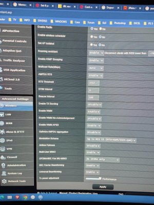

Can you confirm you disabled Airtime Fairness?
If yes, can you post a picture of your wireless/professional tab settings so we can see what's going on?
It's disabled. But internet its working, only cast in some apps
Disable Universal Beamforming.
Why Roaming Assistant Is enabled? You have One SSID for both 2.4 and 5ghz (if so prepare to split them)? Clarify this point thanks.
