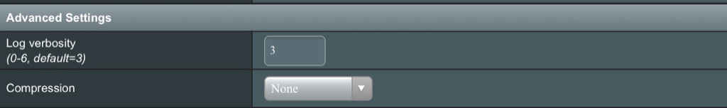

I dont use the same vpn-provider but mine gave me the option to disable compression a few weeks ago.
I had to choose on my vpn provider account page to disable compression (can use compression if i want it)
First tried compression disabled did not work
compression none works for me
Think option None still has a sort of empty frame for compression
Disabled does not

I don't understand why comp-lzo is present in local config when I've set it to None or Disabled. :confused:
I need to look deeper at the config files on the OS to see what is being written out when None or Disabled is configured. Maybe an OpenVPN bug?
Set the 'Log verbosity' to "param" mode (4) , and hopefully all of the parameters should be dumped to Syslog.

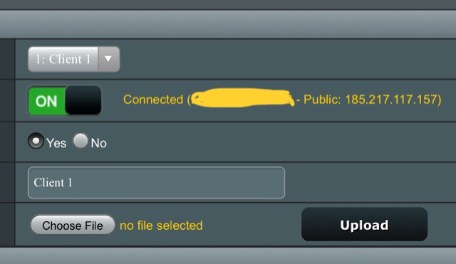

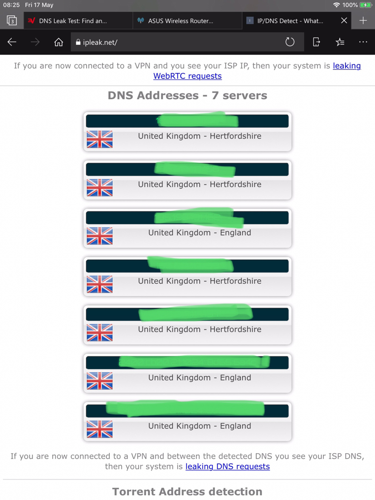

It's strange what is happening as ExpressVPN was working perfectly ok, and I upgraded Merlin then is issue started.
Here is a screenshot of the VPN Client (click on it for larger view):
And here is the results of ipleak.net scan (click on image for larger image):
Usually there's only one dns server.

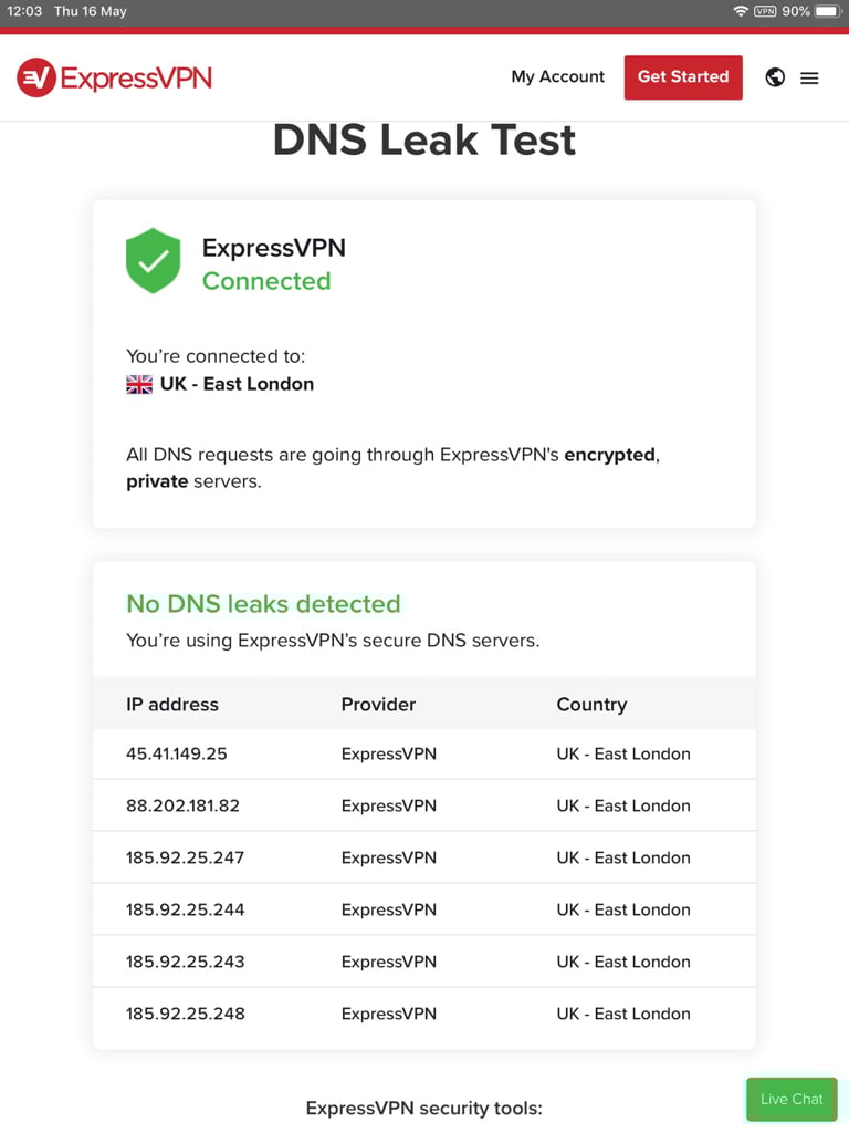

I have the same setup as you, the only difference is I haven’t renamed the client instance or the description
These are my results using ipleak.net
These are the results using https://www.expressvpn.com/dns-leak-test
I’m not worried about the multiple servers being shown, another person mentioned it could be for load balancing.
If you haven’t done already I would download fresh copies of the .ovpn files from ExpressVPN and start over. Also is it just the one client you have running

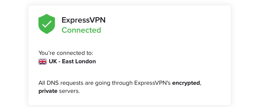

Hi, thanks for the reply.
Using the ExpressVPN DNS Leak page (https://www.expressvpn.com/dns-leak-test) I receive the following result:
No DNS leaks detected
You’re using ExpressVPN’s secure DNS servers.
All DNS requests are going through ExpressVPN's encrypted, private servers.
And I'm able to watch HULU, Prime Video, and US Netflix from Australia.
So no DNS is leaking, because if it was leaking I wouldn't be able to watch those streaming services, the VPN warning would show.

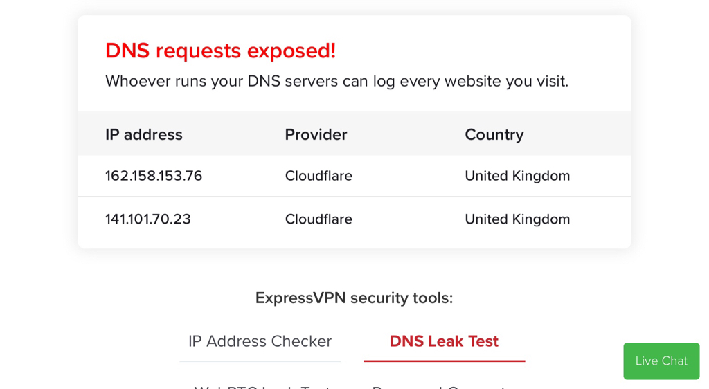

I had a setting wrong when I mirrored your setup, so just to confirm like you there’s no DNS leak with this setup

384.11 had a major change with DNS DoT. Review the settings on the WAN page.
Do you have Cloudflare DNS Client installed or DoT installed in your browser? That would take precedence over the router settings unless you have DNSFILTER set to Router.
:eek: I suspect this may have something to do with the workarounds to avoid VPN blocks. I would ask them about the issue to get their take. Sometimes a friendly phone can result in some insider information that you would normally not get over a support ticket.
