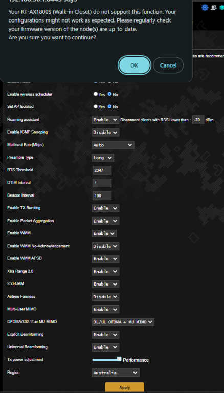

Also with AX1800S as a mesh node with AX4200Q I get this notification when trying to click Apply on Wireless>Professional page
Any idea what's not supported by AX1800S? Will I need to get two AX3000 units for my AiMesh and replace the AX1800S for good, for compatibility purposes? Please let me know...

I've never heard of the AX4200Q before. It looks like a China-only model. I suspect it is objecting to you setting the AX1800S to Australia rather than China. If it's not that try toggling each option one at a time until you find the culprit. My next guess would be "Xtra Range 2.0". In any case it sounds like a warning that you can choose to ignore.
