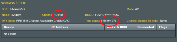

Specs say Channel Availability Check (CAC) must be "at least" 60 seconds in US and EU.
Yes, I was being lazy and omitted the "at least" because I thought that was obvious. But that's not the same for the EU.
The 10 minute CAC is required only in Canada and Australia and only for 5600-5650 MHz.
It's also the case in the UK & EU as seen in the chart in post #20 (5600-5650MHz being TWDR covering channels 120-128). See Table D.1, NOTE 1 of EN 301 893.
