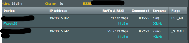

Ok to use channel 13 in UK?
Sure. Although I did have a problem with an IoT device a few years ago that simply didn't support channels 12 and 13. So YMMV.
Nope. Ok if close range but 5Ghz clients affected on channel 52 lol
