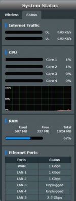

I connected my two AX86U's with the 2.5G Port as per other references I've read, but I'm only getting 100M according to the network map.
Did I read that wrong, or is there something missing? I can't find anything on it .

My two AX86U's show connection at 2.5Gbps under system status on Network Map page - even if there is nothing at all attached to the Node! Actual throughput will of course depend on the volume of traffic - but any tester should confirm the link's capacity.
I don't believe that a fully functional flawless 2.5Gbps port will report variable rate within this Status report.
If it does not show 2.5Gbps then you have a cable, port or settings problem.
