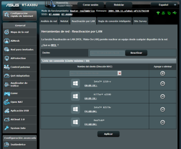

Only no WOL via webinterface buy this is on .10 too. Only on AX88u as is see..
I don't have that problem... it appears for me, and it works.

I know on the webinterface there nothing to see, it looks like everything is working. But it doesnt execute for real in my case at least.

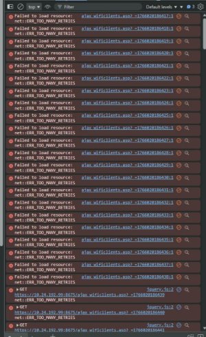

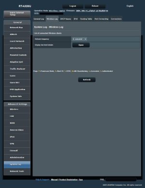

System Log - Wireless Log page doesn't load for me all the way unless I press the Refresh button. Everything else seems good.
What web browser? If there are errors in the web browser console on the page load, post those errors.
PS: Do the usual recommended action of clearing the browser's cache if you haven't done so already.
Browser Edge 144.0.3719.18. Cache cleared.

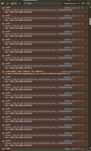

Does the same thing happen if you use a different web browser?
If running any browser addons or extensions in Edge, try disabling them and test if the issue persists.
Works fine in Firefox 146.0.1. Disabled extensions in Edge and have the same result.
