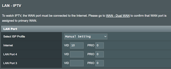

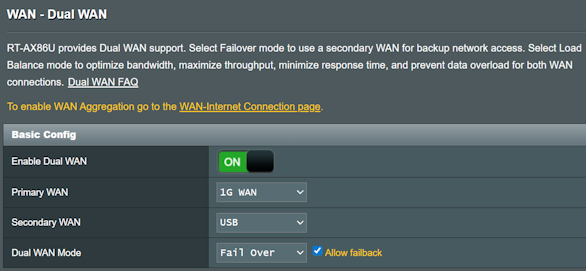

Maybe we're talking about different things. Or maybe what you're seeing is specific to the RT-AX58U.
This is what I see on my RT-AX86U running 3004.388.10_2:
Are you saying that you don't have the IPTV page?
Or are you saying you don't have the dual-WAN page?

Thanks for your reply. When I have set VLAN and trying to configure DUAL-WAN there is a messages that IPTV is incompatible and it's removing VLAN config. What I remember, after upgrading to 3004.388.10_2, the configuration was kept, but DW stopped to work. I performed a factory reset and the situation was like I described above. I downgraded software to 3004.388.9_2, preformed factory reset and configured DUAL-WAN again and it works like a charm till now. I don't want to flash a new soft blindly to avoid any issues with a potential rollback. The key is, that feature doesn't work anymore and after factory reset, the message about incompatibility appears.
EDIT:
Below is an exact answer from Asus (HQ):
When both Dual WAN and IPTV are enabled, some features will not function properly. Users may experience this as working in older firmware simply because the previous firmware user interface did not impose any restrictions.
Technically, if a user actually experiences a failover from the primary WAN to the secondary WAN in Dual WAN mode, it is still not compatible with IPTV settings.
It has been confirmed that in all ASUSWRT models with version 3.0.0.6 and later, the user interface now includes a blocking mechanism that prevents and disallows such configurations.
Dual WAN and IPTV have always been mutually exclusive features. When using IPTV in Dual WAN mode, the IPTV service must be configured on the default WAN port and cannot be dynamically switched.
The new firmware introduces warning messages to prevent customers from creating conflicting settings.
