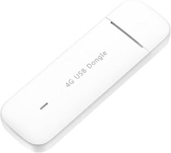

I’ve experimented with LTE/4G USB Dongles tailor made for this purpose and while I eventually got it working it’s been a bit hit and miss and you need to make sure you get one compatible with your region.
If you do go that route there’s a couple of main types, the ones that have 4G/LTE together with their own Wi-Fi network (so essentially mini router-like capabilities). On these if you can you’d possibly have to disable (or maybe ignore) that Wi-Fi capability to see if the LTE part worked. These are by far the most common dongles e.g. HUAWEI E8372h-153 (I had one). The 153 part might be different for your region…
The other main kind are the LTE only ones like the E3372h (there’s also an s variant which apparently more natively interfaces with your router but is a bear to setup). I had one of these too.
For both I had to set up the new SIM card in a phone first as it was by far the easiest way to do so.
So given the above a phone is … just easier for a temporary use case; unless you have such an animal and just want to experiment.

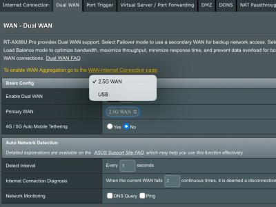

I believe all you’d need to do then is just select USB as primary WAN … which you’re probably doing with your phone anyway.
