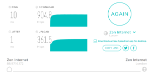

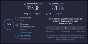

It just over 24 hours since my new Full Fibre 900 Internet service with Zen started and I'm trying to evaluate the speeds I am getting. However, the results from the router differ widely from what I get on my Windows 11 laptop when connected via an Ethernet cable. Can anyone explain what might be going on here?

Ignore speed test results on underpowered consumer routers (currently, that is all of them).
Do a forum search and you'll find numerous discussions about this exact issue. The answer across the board is pretty much the same as L&LD indicates. The router's speed test often shows a speed around half of what a computer will show due to the limitations of the router's hardware (it's processor). Others, in past discussions, have indicated it's due to the router using a single processor core to run the speed test.
What I find particularly puzzling here is that the router is showing a much higher upload speed than my Windows 11 laptop.
how fare you have laptop from router? do you have different internet cable to check like cat 6A - short connected directly to router no via wall socket). try different LAN driver. Do you have any AI internet app that can slow down transfer.
what LAN hardware you have - for example Intel i225 v1 and v2 have hardware bug. Here is how you can check process that inform something is wrong https://linustechtips.com/topic/148...-v-25gbe-has-a-connection-drop-issue-updated/
There is nothing puzzling here as already stated the router speed test is USELESS , the router cannot handle the data and you'll get inaccurate results.

Actually, my old connection was also FTTP (BT Full Fibre 500) and I typically got just over 500 Mb/s down and about 72 Mb/s up. The Ethernet connection result I uploaded at the beginning of this thread seems to be the most reliable so far, but I'll try it again using the Zen and nperf links kindly provided by AndreiV, in the morning when no-one else is using the internet on my home network. I'll also test the FRITZ!Box to see how that compares and I may even try the latest stock firmware on my ASUS router, so I'll have the bigger picture. Then I'll relax for a bit and do my daughter's ironing LOL.

Well since this morning I'm even more confused. I tried a few speedtests on my ISP's site (Zen Internet) and the download speed had dropped to around 74 Mb/s on a Full Fibre 900 service (I tested from my laptop connected to the ASUS router via an Ethernet Cat 5e cable). Then I carried out the same test using the FRITZ!Box 7530 AX and got over 900 Mb/s down and over 300 Mb/s up. Then I removed the US flash drive and performed a full factory reset. This restored the download speed to where it should be. My next step was to install the latest stock firmware, but after doing that and performing another speed test, I was disappointed to note the the download speed had once again dropped to the mid 70's. Also, when carrying out speed tests, the download graph was fluctuating widely during the test. It seems that my ASUS router doesn't like my new CityFibre broadband, so I've taken the ASUS router off the wall and replaced it with the FRITZ!Box. The Wi-Fi isn't as strong as with the ASUS router and there are less option to customise things, but the internet connection seems more stable. These are the last two tests I did after finishing the swap over this afternoon:
