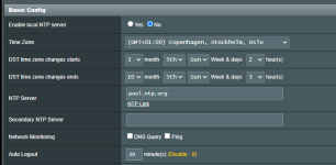

Did fire up an ac88u with Merlin 386.4 the other day and it has no such problems on Altibox (Stor Oslo area). The only config I have done so far is set the timezone settings (see pic)...
