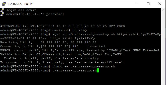

I have tried following post 24 but the language is foreign to me.
What is "Install an updated curl using entware" and how do I do that?
Have I done steps 1 and 2 right judging by the picture below? The following script was added to the services-start file

Hi, I had a clean install of merlin 384.19 on my RT-AC66U_B1, this script did worked first time, but after I log back in amtm still gives error messages when installing a module or doing an update.
Did follow your instructions, the script did say "all done here" after first run. Running it again didn't help.
I see where it goes wrong with your firmware version, it cannot use the newly installed Entware curl binary.
To correct this I have made some changes to the amtm firmware version and ca_cert_check.sh file.
Run this first in the terminal to again set curl download to insecure:
echo insecure >> $HOME/.curlrc
Then open amtm and force update it by entering uu.
Then exit amtm and run the ca_cert_check.sh line again in the terminal to make sure all is set correctly now.
