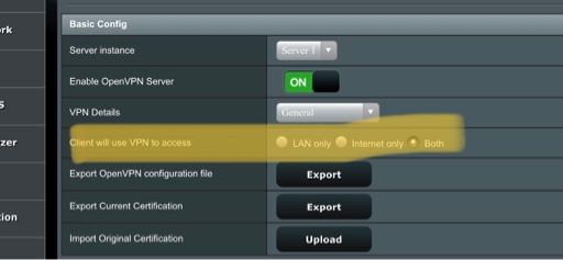

That’s my point, push the route AND set the router to allow WAN/internet access for VPN clients. I suspect the router is not allowing traffic from VPN>WAN
To be clear, this needs to be set to both...
Ok thanks I changed it and allowed WAN access to the clients. Now the Fritzbox is accessable but it looks like that also all internet traffic on the clients is now routed over the VPN which I do not want. Only the traffic for 10.10.10.0/255.255.255.0 shall be routed via vpn to the server WAN port.

To successfully implement a VPN connection between two Asus Routers to connect the LANs at two separate locations, configure the OpenVPN Server on one Router as follows:
You need to set Username Authentication to YES. The allowed Client Names are the Usernames that you configure in the OpenVPN client. Note the "--username-as-common-name" line in the Custom Configuration. This is essential to make this work. Note: In this example, the OpenVPN server is configured to accept clients from 3 separate routers, each with a different LAN subnet address.
The OpenVPN Client in the other router should be configured as follows:
In the client you need to change Force Internet Traffic thru Tunnel to "Policy Rules" and then configure the subnets on the remote router as shown. In addition, you should set Username Authentication to YES and Create NAT on Tunnel to NO.
One thing I forgot to mention. On the VPN Server Configuration, you need to set "Client will use VPN to access" = BOTH. With that setting, all connections to LANs that you configure on the VPN Client (except for the VPN Server's own LAN subnet), will be routed by the Server Router thru its WAN interface using NAT. This setting will NOT cause the Internet traffic from the Client Router to use the VPN connection, if the VPN Client's routes are configured properly.
