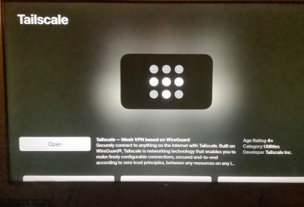

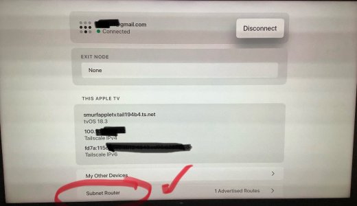

Until I changed provider, I had CGNAT on a remote router I need access to.
@bits is absolutely correct, if your provider uses CGNAT (it saves them IP addresses apparently) you can’t get through it without one of a few options. I list two of them below, ones I am familiar with through personal experience.
You can pay for a static IP address or you can do what I did (still do), set up and use Tailscale.
If you already know about tailscale ignore what follows, if not then for this you can either:
  • Set up and configure any device attached to your network and always on, as a subnet router. This device will ‘advertise’ itself outside CGNAT and you can then connect to your LAN, including your router e.g. you can use a Raspberry Pi (my first foray into Tailscale) or if it’s always on, an AppleTV HD or 4K (a very simple option, see pics attached) or literally any other device you can install tailscale on (and there are multiple OS platforms and literally hundreds of Device types to choose from).
  • If you’re on RMerlin FW, set up Tailscale on the Router. A very easy way to do this is to install TAILMON, an amazing Addon from @Viktor Jaep, this is what I now use, as the router is always on and I don’t need a separate device, although I do keep my Apple TV as a backup subnet router, which I can just enable if I need to, although I never have.
