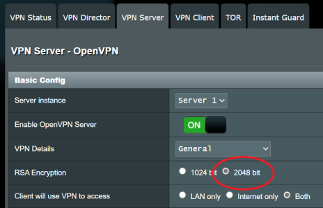

My first guess would be that you need to go to your VPN server's General Settings and set RSA Encryption = 2048 bit.

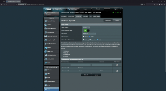

I am just not finding RSA Encryption = 2048 bit.
VPN Server - General1 -
Even when I select advanced settings.
(apologies for being a pain)
Do you have this:
I do not have that option showing.
You said previously that you're using Merlin's firmware 3004.388.8_4 but that doesn't seem to be the case?
Set the VPN server to OFF and Apply that change. Then select ON and you should see the RSA option appear.
Holy heck Batman. Just like you said. Thank you.

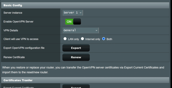

Well, you can actually, but admittedly, the crucial step might not be readily obvious or intuitive at first. Here are the full steps to change the RSA encryption key size for an already configured OpenVPN Server:
- Toggle the OpenVPN Server instance to "OFF" (#1) and then click on the "Apply" button (#2).
- Toggle the OpenVPN Server instance back to "ON" (#3), select the RSA key size (#4), and then click on the "Apply" button (#5) found at the bottom of the "Username and Password" section. You do *not* need to click on the "Default" button.
- Finally, the most crucial part is to click on the "Renew" button (#6) *before* you export the OpenVPN client configuration. This "Renew" step regenerates the keys and certificates using the previously selected RSA key size.
That's it.

During the process of setting all this up, I noticed that the RSA key size option became available only when toggling the OpenVPN server OFF and then back ON. Later on, while playing with some options, I read the tooltip that pops up for the "Renew Certificate" title (see sample screenshot below), which was the key piece indicating how to regenerate the keys & certificates when needed *without* reconfiguring the server.
