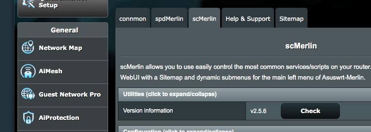

If I navigate directly to the URL for scMerlin, it displays correctly ie. the UI is displayed correctly with the scMerlin tab in the foreground. See attached screenshotA.

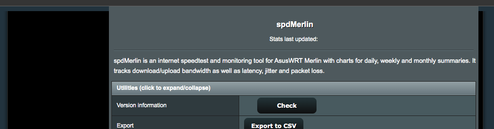

If I click on any other tabs, the page replaces the UI shown. See attached screenshotB.
