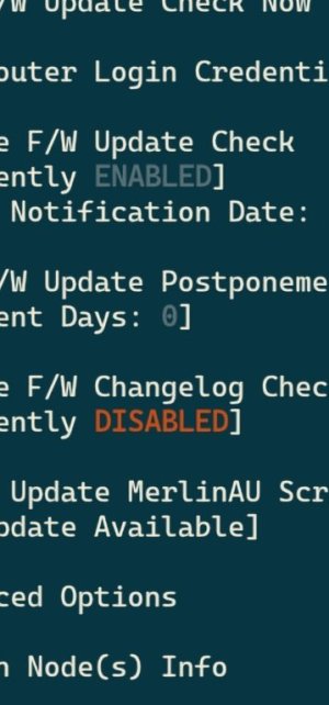

Thanks @ExtremeFiretop, it was really set to 0.
FW update check interval is ok, but installing is postponed some days, when I set it to 0.
Hi! Please send your cron schedule as mentioned in the original reply.
Thanks!

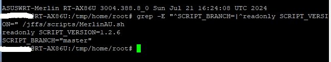

I did that forced update at the time but is there a way to easily see which branch you are now on so you know it ‘stuck’? Preferably from within the menu accessed via amtm?
As long as you did the forced update your on stable.
I've changed things back around in the dev branch, so if you were on dev, you would see version 1.2.7 available instead of 1.2.6
If you run the dev commands now, it would download v1.2.7 in development.
Here's one way to quickly double-check and verify what you have currently installed:
Bash:
grep -E "^SCRIPT_BRANCH=|^readonly SCRIPT_VERSION=" /jffs/scripts/MerlinAU.sh
Bash:
Martinski is too good, giving you all the tricks!
And just to be 100% clear, "SCRIPT_BRANCH" being "Master" is the stable branch.
if "SCRIPT_BRANCH" says "dev" then you've managed to find your way onto the development branch.
Bash:
Oh, you are a star! Thank you :)

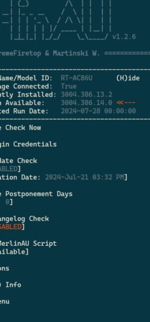

Dear developers,
A polite request:
Is it possible to include this info in the email notification?
"The firmware update is expected to occur on 2024-08-02 05:45:00."
The number of days postpone is also important, but with that extra info I know exactly when the update will occur, not needing to make calculations 🙂
Thanks in advance

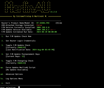

In Option 2 "Set Router Credentials", do I need to set that for the script to function? I only want to use it for email notifications of a new release, I prefer to do the actual update myself as I only have the one router to deal with.
In Option 2 "Set Router Credentials", do I need to set that for the script to function? I only want to use it for email notifications of a new release.
In that case you should be using the included script with AMTM by @thelonelycoder
Mine is specifically for people that want to auto-update safely (using SHA265 checks, changelog checks, etc)
If you want MerlinAU to do the updates for you, but only manually without a schedule, you should disable the "Toggle F/W Update Check" at which point it will only update when you run option 1 manually.
If thats how you want it setup, yes you would need to use option 2 since it needs to login to the router to do the update.
Note that when the user disables the "Toggle F/W Update Check" option, it effectively disables the router's built-in check for new firmware availability. The two settings are currently bound together.
IMO, the better strategy is to set the number of postponement days to the current maximum of 60 days and leave the "Toggle F/W Update Check" option ENABLED. This allows you to still get F/W Update notifications when a new F/W version becomes available, and also gives you enough time (i.e. 2 months) to decide when to manually do the F/W update.
