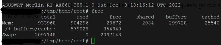

To check free memory you can use "free".
But I don't understand the relation between free memory and dns encryption?
