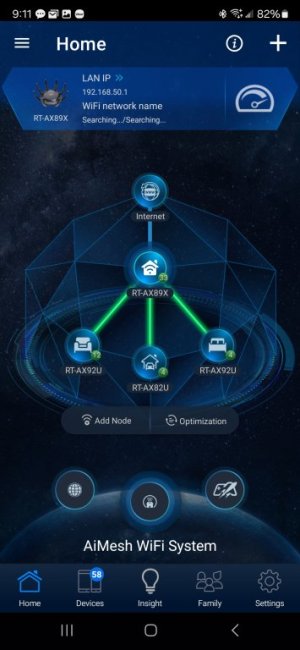

Hello everyone.
Hopefully someone can help shed some light on this weird issue.
I have a RX-AX89X connected directly to my cable modem in the basement.
I have two RT-AX92U routers set as my nodes. One on the main floor and on on the second floor. They are both hard wired with CAT6 Ethernet.
Everything has been working great for several years now.
The problem:
One night this past week I was poking around on the Asus Router app on my phone and noticed that both of my nodes have been disconnecting and then reconnecting at random. When the nodes disconnect, all the wireless devices connect to the RX-AX89X, then when the RT-AX92U nodes reconnect, slowly the wireless devices reconnect to the nodes. Sometimes one node is connected and looks fine while the other is offline and vice versa. Sometimes they are both offline, or both online.
So thinking that something is wrong I rebooted the nodes and then they came back up no problem but a short time later they dropped off again. So then I rebooted the RX-AX89X and again.... same issue.
Then I checked the web interface of my RX-AX89X and it looks like this:
Sometimes one node is up and the other is down so it looks like this:
Then I tried resetting the nodes to factory settings and then set them up as nodes again. Same issue. Then I reset the RX-AX89X to factory and set everything up again but the issue persists.
Thinking that perhaps something is wrong with the CAT 6 ethernet runs to my other floors, I took one of the RT-AX92U routers to the basement and connected it directly to the RX-AX89X and the issue persists.
I'm thinking that the problem is either with the RX-AX89X or the RT-AX92Us. I'm running the latest firmware on all three routers.
RX-AX89X is on 3.0.0.4.388_32407.
The RT-AX92U routers are both on 3.0.0.4.388_23630.
Could this be a problem with the firmware on these routers?
Anything else I could be missing?
Any help or suggestions would be greatly appreciated.
Thanks everyone!

Hello again and thanks for the responses.
Here is some more info that may help.
Since I have reset to factory defaults, Ethernet Backhaul Mode is still disabled. I never had it enabled before the reset either. WPS is currently enabled. WIFI settings are all currently at default.
I was using a switch between the RX-AX89X and the two RT-AX92U routers but have since moved them to connect directly to the RX-AX89X as I thought perhaps my switch was the problem. It isn't.
I've moved the ports for the two RT-AX92U routers on the RX-AX89X but no difference.
I had a look at the System log but I don't see anything that helps. Perhaps I just don't understand what's happening or what I'm reading in the logs. Here is a snip of the logs.

They just updated the firmware on the 89X in late October. You could rollback to the previous firmware, run it for awhile and see if it is any better. If nothing else, it could tell you if they broke something in this latest update or rule it out if it keeps disconnecting.
Hello everyone and thanks for all the replies and suggestions.
Looks like Brad was correct. I downgraded my RX-AX89X from ASUS RT-AX89X Firmware version 3.0.0.4.388_32407 to 3.0.0.4.386_47468 and now my two RT-AX92U routers set as my nodes are showing up just fine again.

Hi, I posted about this same issue 5 months ago. I'm still running the previous firmware. I'm thinking that because they discontinued the AX92U and also stopped supporting it that we are either going to be forever stuck with that previous firmware version or replace the two AX92U use that I'm running as wireless nodes. I think I should mention that under the previous firmware version 3.0.0.4.386_47468 both of my AX92U are connected at 5G wirelessly and I can get almost 1 gig up and down. Have you had any solution since you have posted this months ago? Thanks
Not a big issue for nodes. Use whatever firmware works. There is no routing there. In your case they are repeaters.
Maybe I did not do a good job explaining what I was trying to say is that if I for example want to continue to use AX92U as node repeaters then I will always have to use firmware version 3.0.0.4.386_47468 on the ax89x because the issue of the new firmware improperly handling the wifi connection to the now unsupported ax92u. Either keep version 3.0.0.4.386_47468 on the ax89x or replace the AX92U with a different newer model
Understood. This is unfortunate. In this case the only option is to keep AX89X as locked as possible with nothing exposed to Internet.
