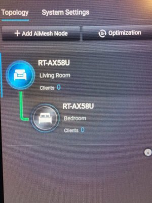

Another thing i notice is that before and after adding the AP, on the AiMesh menu the Clients always show 0, when in the network map there are 34.... firmware bug?
