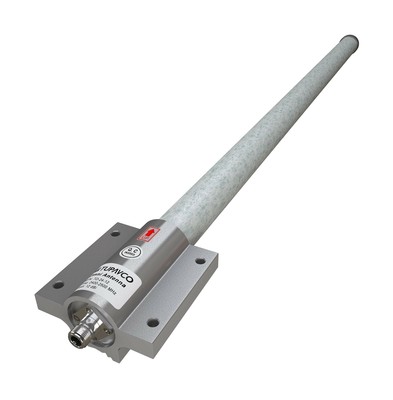

The only thing I have ever seen that has improved the ability for a router was something like this:
I had one of these inside a utility chase at a hotel and it took care of all the dead spots. I had to get an adapter cable to connect it to the router. The slightly longer stock antennas didn't really do much to help, but they also did boost a bit.
