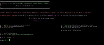

Unbound Any idea on this error message from the installation process?
donduck
My unbound manager install process crapped out today. The internet connection was disconnected during the install (not sure why).
Now I couldn't uninstall/reinstall unbound manager... i even tried formatting the usb stick :(
Screenshot attached if anyone could help! (I am a total noob so I don't know what commands could fix this)
Thanks in advance!

Did you try menu option 2?
e  = Exit Script [?]
E:Option ==> 2
so unbound_manager should remove itself.
The error you have shown is usually caused by an Entware issue
so I would perform a fresh install of Entware, then re-attempt the unbound_manager install.
