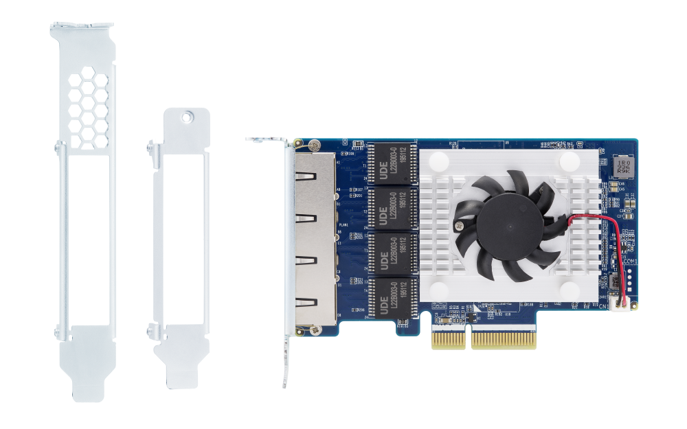

Same goes for N-BaseT 2.5/5GE port switches. I can pick up a quad port 5GE NIC for $200 but the same in a switch is over $500. I can get a dual port 10GE NIC for the same cost but, switches are much higher. This is where the DIY PC Router comes into play if you're looking for more than consumer grade connections but not quite spendy enough to pay up for the SMB / Enterprise gear for a couple of devices.
I haven't looked into it but, I'm guessing there might be a market for POE NIC interfaces which would be easy to accomplish by hooking up a SATA Power connector to the card like you do with TB to get 100W PD off the port. Speaking of which - $360 / 4 ports
Hmm ... I'm not sure that's an apples-to-apples comparison. A NIC will give you some I/O pipes, but a switch backs that up with switching fabric that can push bits from pipe A to pipe B --- and people expect it to also be able to push bits from pipe C to pipe D, concurrently, at full speed. There's a lot of hardware involved in that. Not to mention whatever management functions it might have. I think you really need to compare to the whole cost of that DIY router.

I have the AP / 5G Gateway connected to it with the ports split between WAN / LAN and there's no issues with hitting speeds. I have 2 ports bonded to the GW and when needed connect the laptop with a USB-C 5GE dongle and can max out the storage speeds over the wire at over 400MB/s on spinners.
Once you setup the box there's minimal maintenance if you choose to do so. Costs vary though depending on your requirements from $200 for a SFF PC + NIC to your unlimited budget where you want everything and then some more. I rolled several devices into a single box which those devices add up to ~$1000 which compensated for the parts costs on the initial build.
