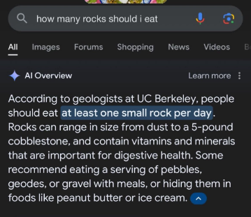

I believe I tried Google
Pretty accurate information for @BeachGuy to take. Have some sand around? - make a smoothie.
