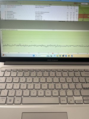

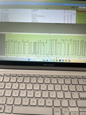

Morning all, I’ve switched out the BT smarthub because it was performing shockingly. WiFi drop out and in general poor performance. I went and bought this new one ASUS DSL AX82U however I’m struggling with high ping figures on a wired connection. As you can see below there are 2 graphs. One from the original BT smarthub 2 and the other from the ASUS one. I can’t work out what is causing the ASUS one to fluctuate all the way up to 65ms at times yet the BT one seems to keep a steady line under 15ms.
I’ve got the ASUS plugged in directly straight to the fibre line in a pppoe connection. I will also attach the setup pics on my router aswell. Can someone help me figure this out please? Thanks in advance.
