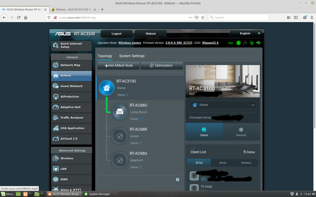

I have a question about the new ethernet backhaul optimization settings and the use of a network switch.
So from the image you can see I have a rt-ac3100 as the main and then 3 nodes. The node that shows up in the image as "working" is hardwired directly from the rt-ac3100. I have a netgear fs105na switch that is hardwired to the rt-ac3100 and then the two nodes are hardwired into the switch. These two nodes are not working as the image suggests. If I just go back to the not optimized in the new settings it works but is there any reason that a switch should not work here or can I fix this??

Did you set the node Connection Priority to '1G WAN first'? If left on Auto, maybe the switch is defeating that, and maybe you enabled AiMesh Ethernet Backhaul Mode, so no wired and no wireless backhauls.
OE
I did set the connection priority to 1G WAN first on my nodes. The one that is working still has that setting.
I did enable the ethernet backhaul mode and so the wired node is working fine in that mode. So should my two nodes that are connected via the switch not work in ethernet backhaul mode... is the switch defeating the backhaul mode? I know the firmware is pretty new for the AC-RT3100 so is there any settings I can do to fix that.?
What happened to that setting for the other two nodes?
Yes, the switch is probably the issue.

I have also experienced problems with 3 nodes in AIMESh with backhaul mode turned on. Sometimes the nodes are not pingable, and the GUI will not work.
I found through trial and error, by powering down one of the AIMESh nodes and restarting it, the system will come back online.
Also, you will not get full 1Gps speeds when connected directly to your node WAN port. You need a 1Gb switch in between, then plug it to your node. Then you get the full 'Great' speeds...
The GUI reports that I cannot change or view the config of the nodes as they are disconnected.
I had disabled the ethernet backhaul and power cycled the not connected nodes and cannot get them back connected yet.
edit:
i also cannot ping the nodes from the ac3100
Yep the first power cycle didnt do it. But another power cycle did work after I turned off the backhaul mode.
So with the switch I can maintain what I had before the firmware update: nodes connected via switch. But with backhaul mode enabled I could not get my nodes behind the switch to connect.
I have a master and 2 nodes In wired 1 Gp backhaul mode. One node lost power, and it took the other node down. Both are powered up, and I've been waiting for a couple of hours and both still have not come back.
Just a follow-up on ethernet all node mesh backhaul mode. At least what I've found. If any nodes in the mesh go down, the entire mesh network goes unstable. It takes a lot of restarts, sometimes with the non-fault node to bring the system back online.
The system seems to work best to not turn on backhaul, but set each node to prefer the 1Gps connection over wireless. Each node will then use ethernet for traffic back to the master, yet if any node goes down the system stays up.
