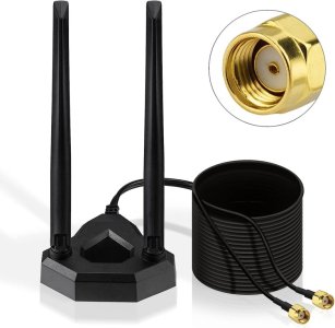

Hi all,
Came across this forum whilst doing some research regarding my FTTP Sky Broadband. Long story short, the Sky Hub kept rebooting at random, customer service help was less than desirable, so I dug out my old ASUS RT-AC86U to give it a whirl. I found guides on here on how to set it working with FTTP and so far it's been working great - for the most part anyways.
Some background now, I've just moved into a rented, brand new build. I'm the first tenant. There's no landlines, it's direct FTTP only. Now, as wonderful as that is, the builders / architect / whoever clearly weren't very tech knowledgable!! Whilst they did install RJ45 sockets around the house using Cat 6 cabling, for some stupid reason they decided to a) have the FTTP enter the property into the under-stairs, small cupboard which also houses the immersion tank / heating stuff, right at the back. and b) have all the household sockets route back to the same place, next to the ONT. I honestly don't know what the hell they were thinking!! Literally THEE WORST possible place to be putting a WiFi router! The hottest little cupboard in the entire house that's also surrounded by metal, wiring, water piping and a WiFi (Samsung Joule) thing etc etc - you get the idea - absolutely stupid place for it!
But alas, I can't move it, nothing I can do and not feasible (nor plausible) to somehow extend the power, ONT and also ethernet cables anywhere else or even outside the cupboard. The ASUS router was reporting temps in the low 90. I found posts about using fans etc, and I am now at a decent 50-60 max. So that was one issue sorted, and this leads me to my question.... My WiFi devices are struggling to get a decent signal unless stood by the sodding cupboard!
Since I'm pretty poor, and can't afford to start building a fancy mesh network with multiple wifi routers / extenders etc, is there any thing anyone can recommend that I can use to perhaps boost the antenna signal? Or even use instead of the antennas that it comes with? Something like the attached picture for example (Which is intended for use with a dual wifi card in computer rather than a router) but for a router?
Many thanks in advance

This router has 3x external antennas and 1x internal printed on a small PCB. You can replace the external antennas with higher gain ones, but you can't do anything with the internal one. This makes sense only if you need more range in horizontal plane - if your place is a single storey bungalow or an apartment. Good lick finding good quality high-gain antennas though. Almost everithing on Amazon and eBay is fake and worse than what the router came with. In general - not recommended. Use the cables available and move the router to more central location. Use Wi-Fi connections.

You'll probably cause more problems than you solve. Higher gain antennas will narrow the signal, and amplifiers amplify noise even more than signal.
Just use one of the ethernet runs to extend the ONT to some other room and plug that into the WAN of your asus. If you want wired LAN too that makes it a bit more complex, not sure if there is a spot where you can access two ethernets, one for WAN and one for LAN, then put a cheap switch in the cupboard to merge all the LAN together (leave the WAN separate).

Hi, Thanks for the reply - yeah, I'm getting that general impression about the antennas on eBay and Amazon (I should add, I'm in the UK for what it's worth)
