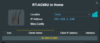

In this fw i loosing my AC-68U node.
After adding the node correctly, it disconnects after a while (so far the node uses to connect to the router the 5GHz band, now after adding it use 2.4 and the signal is weak (despite being in the same room for test.), but instead of switching to 5GHz, it disconnects and spam continous wlcevent in syslog for node's 5GHz
After added node
A moment later
IMO not normal behavior
PS. I back to FW_RT_AC68U_3004_386_46065 for node and everythink work ok,.

Yep, this new firmware is bricking AIMesh setups. No matter what I try. Seems I need to revert back on all of my nodes.
perhaps it's because of the node's firmware is newer than the main router's firmware?
cause ASUS didn't release 48xxx for AX model yet.
no, i have AC86u and AC68u.
