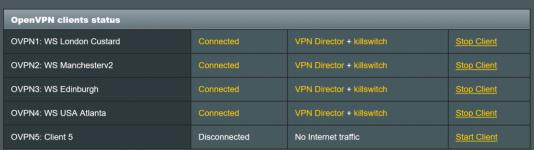

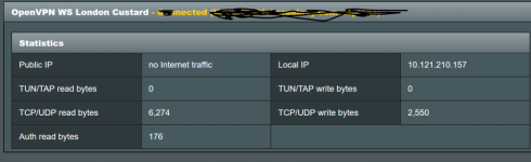

Hi
I have been using merlin for RT-AC86U for over a year now, all of a sudden my external IP is showing as my main ISP location on whatismyipaddress.com
Also on service status status it is showing as Connected (Local: 10.114.182.51 - Internet not redirected)
Any ideas, as I have rebooted the user and re-setup the OpenVPN client. usually when this happens I reboot teh router and issue is resolved.
I do not understand why midway through a working setup this has started to happen as it kind of defies the point of havng a VPN when your location is not changing.
I have 2x VPN setups ExpressVPN and Windscribe and both have the same issue.
eg: my ISP location is showing as manchester and my vpn is connected to london, on whatismyipaddress the location is showing as manchester
Any help would be appreicated.

Did you just upgrade to 386.4 from a release *prior* to 386.3x?
That would be a yes, I will try director and post an update later

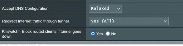

Sounds as if you still have "Redirect internet traffic through tunnel" on the OpenVPN clients set to No. They need to be set to "VPN Director".
ok I kind of got it working by amending the following option in VPN CLient settings
However it seems like all traffic is getting diverted to ovpn1 eg london
whereby I want all traffic to go to the reserved policy rules on VPN Director
eg Laptop 1 use ovpn1
Laptop 2 use ovpn2
firestick use ovpn3
all the time

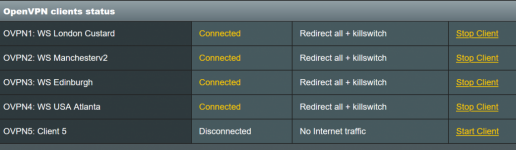

Yes (all) directs ALL traffic over the VPN, irrespective of any VPN Director rules you may have created. Also, it's NOT a good idea to use anything but VPN Director when you have multiple, concurrent OpenVPN clients, since you risk nested tunnels (i.e., one OpenVPN client be routed through another). That hurts performance and creates a dependency; should the outermost OpenVPN client fail, it will take down the others with it. You can't even control which gets nested through which, since they all connect in a non-specific order.
Ok I have set them all to VPN Director, so no nested tunnels, however all traffic for all devices is using ovpn1 and ignoring my order :(
sorry for being a bit dumb, but just learning on the fly :)

Please don't post 'bare' output like that. Use the 'Code' marks available in the toolbar when you're replying.
When you added the 'code' marks, you ended up replacing the output from the routing tables w/ the output from ifconfig. I still have the original output from the latter saved, but it might be confusing to others.
Based on what I'm seeing in the ip rules and routing tables, it should be working. I don't see anything wrong. At least not yet.
Each of the IPs listed in the VPN Director are using a different OpenVPN client. And I can see that in the ip rules. And each routing table is configured w/ the correct default route for its OpenVPN client.
