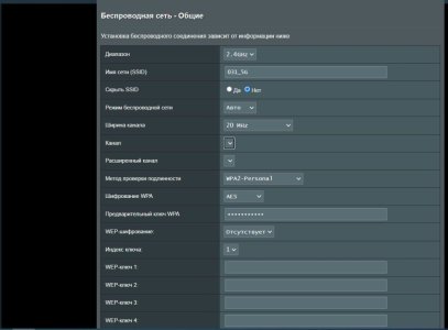

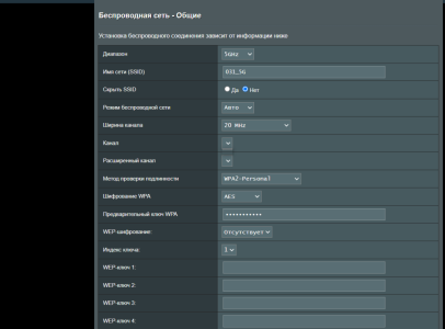

Maybe you have encountered such a problem and can help, thanks in advance for all the answers.
I stitched for the firmware from Merlin 384.13_10. There is no channel selection in the settings (for both 2.4 and 5 Ghz), just an empty drop-down menu, plus there is no menu on the left, as well as an additional menu on top. There is also no 5ghz network in sysinfo it is indicated that 5hz is generally turned off. It was stitched through Asus Firmware, followed by a complete reset of nvram. I don't think it should be.
I thought that the firmware was crooked. I tried to reflash 5 times, I tried different firmware (hugo, merlin, official). Outcome is the same
I also found "5 GHz radio is not ready" in the logs
