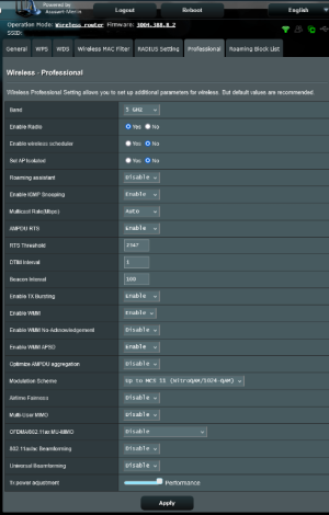

I have an RT-AX3000 (same as your 58U) but now using it as a node when getting an RT-AX86UPro. Here is a screenshot from my 5G Pro settings while back on 388.8_2.
For my neighborhood, I use channel 157. The other setting, OFDMA/802.11ax MU-MIMO, is set to DISABLED. There is also a new ASUS release for this model if you want to try. It primarily fixes some IoT things which is not really your issue. I have a simple network and do not use scripts, etc so not sure if this would something easy to try..
