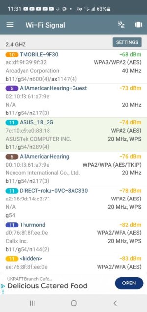

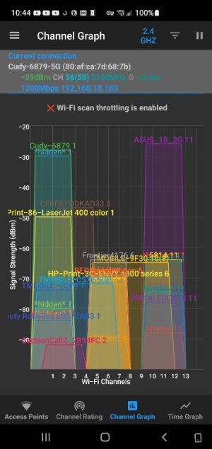

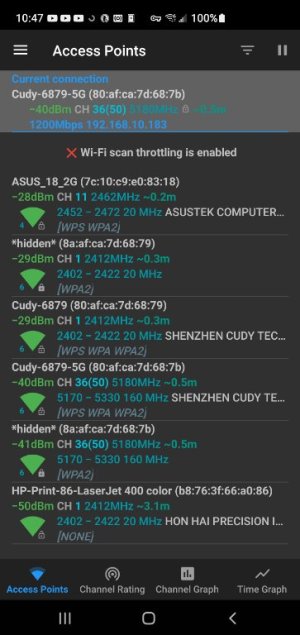

These are 2 analyzers I use everything looks good inside the apartment, it's when I get outside when it drastically changes and like I said the last 3 weeks,before I used to be able to pickup to my car in the parking lot which about 90 - 100 feet away
Which AP is yours, Cudy_6879? What about ASUS_18_2G that also looks to be yours?
I would do another set of Wi-Fi scans from your parking lot and compare.

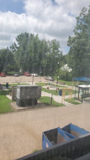

Here is a picture of where my car is( the gold chrysler 300m) looking from my apartment window my router is in the frontroom by the window ,this should give you an idea of the distance I was getting a signal from and to which I thought was very good but something has changed....I m thinking there are a new routers in my building that maybe overpowering my once strong signal

If your Wi-Fi has worked at the distance your car is parked in the past, then I think you've been lucky, and you need to lower your expectations a little. So I wouldn't be buying a third router to fix something that isn't really broken. I'd probably be spending time and effort to get the printer back up and working on the main network, and moving away from the default network names your router(s) came with.

Be sure to try moving the router about... sometimes a small change can make a difference. Also, I found that my double-pane windows with wire screen block more signal than brick facia with wood stud and drywall.

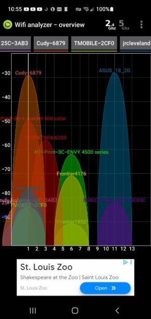

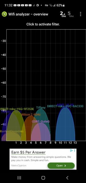

Well I got my printer connected back to my Asus router using WPS PIN, and I turned off the Cudy cellular wifi it seemed to help with my reception outside plus I turned universal beam forming back on on the 2.4GHZ channel

The 1st graph is halfway between my car and apartment building, just a side note you see that Core G suite signal,that building is 3/4 of a block away from me....what do you think they are using setup wise to broadcast that far with a decent signal

I think what you've shown, is that your router is working "within spec". From what you've posted I would assume there are retail units below the apartments. As for the "Core-G" network, it may be that they have multiple Access points, including on the outside of the building facing your block/carpark.
*Looking at your output from Net Analyser app, it may be that at some point I've either paid for a pro version or was on a beta program that gave me additional features. *Not all alpha/beta programs are worth signing up for especially with IoT devices - the program ends and suddenly you lose functionality!
Thanks to ALL you guys help after doing some tweaking on my settings in The AX88u it seems to be working better got my printer back connected correctly and just about got my range almost like before....I want to note one other thing there were about 6 new residents that moved in my building and they all have wireless routers either through T-Mobile or Verizon plus all the cable services so the airways have gotten more crowded there are 65 apartments and over 75% have some type of wireless routers
