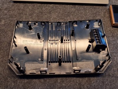

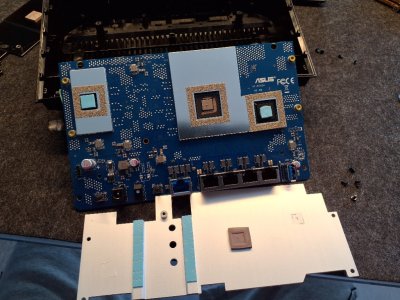

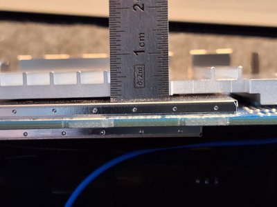

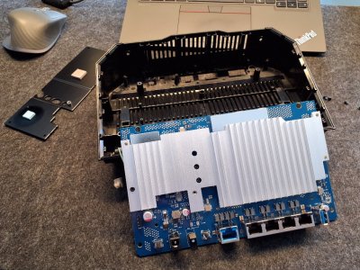

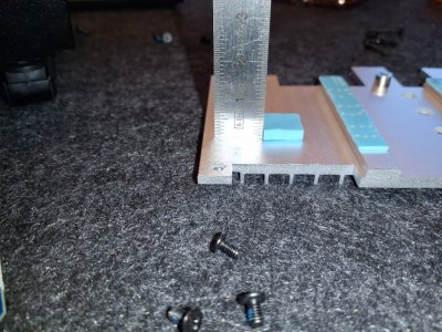

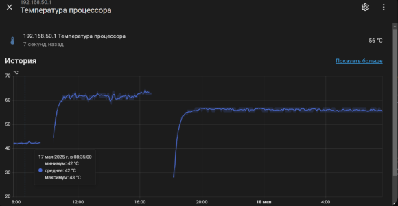

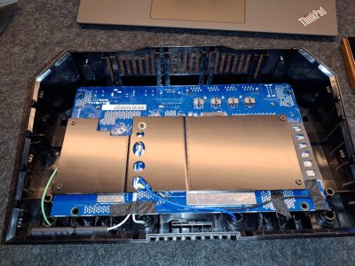

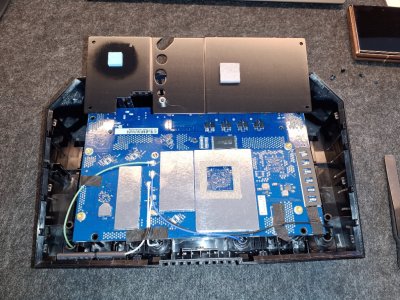

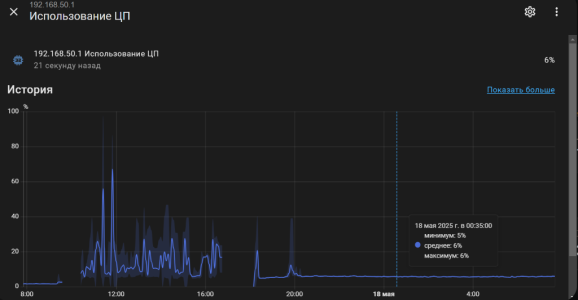

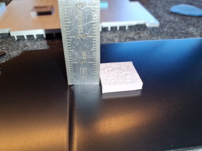

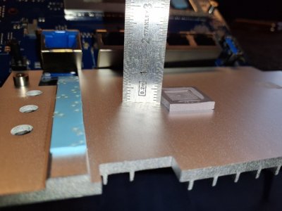

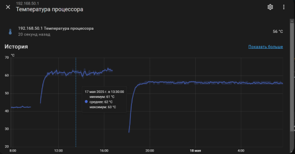

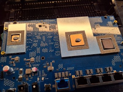

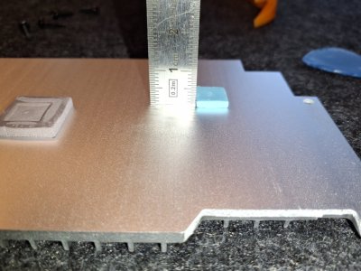

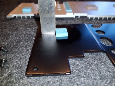

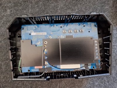

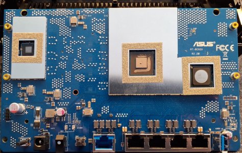

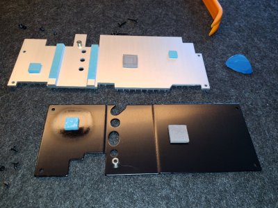

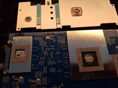

First day of owning a "hot trash can" from Asus to replace the AX88U.
Setup, changing regio to US for more power and channels, disassembly, copper installation, disappointment...
Beamforming doesn't seem to work, we're waiting for them to finish it, maybe the speed will increase...

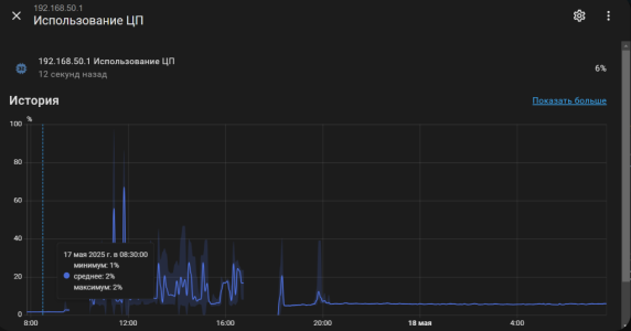

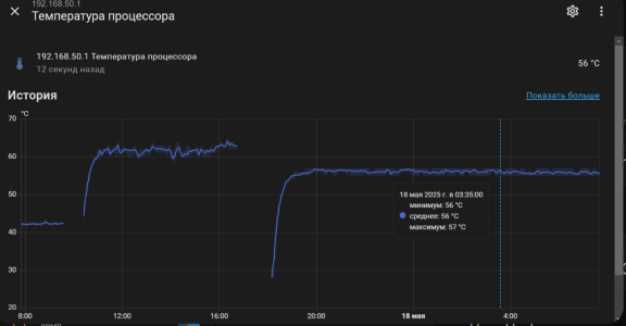

On the graphs from HA on the left is AX88U, then BE92U in stock, then the same + copper.
CPU Load Average in System info is complete nonsense that doesn't reflect reality.
more photos
more photos
more photos
last photo
