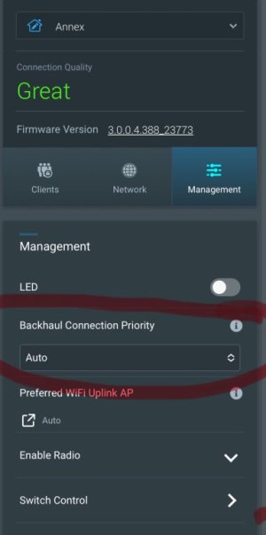

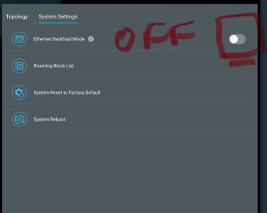

A few folks (including myself) with wired backhaul have had more AIMesh node stability with the Ethernet backhaul OFF and AUTO setting ON as shown attached.
I originally had Ethernet fixed ON and Set As Ethernet ON for both which seemed more correct, intuitively, but it seemed to be less stable with these set that way, so I set them to OFF and AUTO. Give it a try?
btw what FW Version and what Router Node Pairing?

I had it as auto, but not Ethernet as off, as that option did not present itself in the default setting, so I will check that setting.
I have build 24261. Only one node via Ethernet backhaul.
I realized that the setting of Auto and Ethernet off was what it was before when I had the issue. ASUS suggested the back be set to Ethernet only and backhaul as Ethernet. I will retest this configuration but it seems random in how it drops the node.

Sorry for very late reply. To close this out and for future forum readers, indeed reapplying the AUTO setting did restore stability back to the node. It is the opposite of the instructions from support. If you had it on I would recommend changing it to wired and then reset it back to auto.
