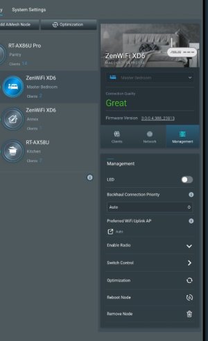

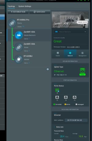

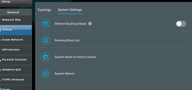

Admittedly I use wired BH (on two XD6 units) but I’ve seen others recommend, as I do, to leave all the settings shown in the attached at default, ie off.
Essentially don’t force a specific backhaul or preferred connection frequency etc. if you already have these as they are in mine, then the latest Stock FW, reset as you have done (worth doing it in the GUI AND then using the WPS method), is the only other thing I can suggest.
