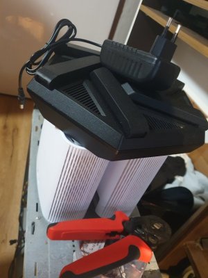

Lol, look whats behind me :D Share the log from the AXE where it fails and drops, may that shows something. Be careful to hide your sensitive data (MACs, SSID)
(Tech9 dont judge me, i just repaired them)
