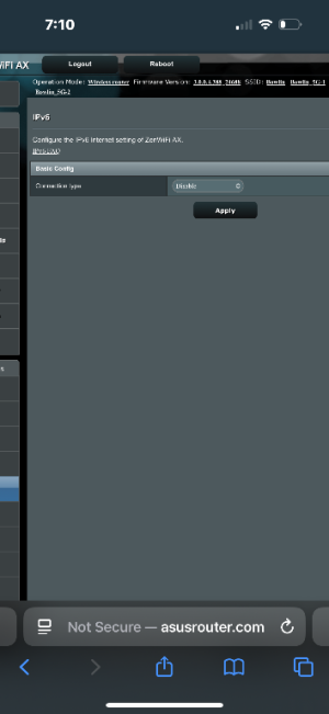

Here are the settings you ask for….i think….looks like IPv6 is disabled
nothing there rings a bell for issues.
