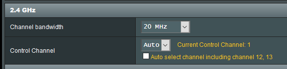

These are my settings, that solved my problems with 2'4-only devices, and with old ones:
In "general":
In "system" altough yo don't use a HD:
No problems at all now.
