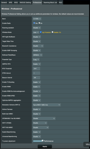

Here are my 2.4Ghz wifi settings. They seemed to fix all my woes on 2.4Ghz. Granted my 2.4 is primarily IoT devices. YMMV. Also are you binding devices to particular AP's? I've seen issues on updates at times for devices that are bound to AP's. I usually have to unbind them for them to reattach.
This helped. I unbound tons of devices and unset the preferred Wireless Uplink Node settings for the different nodes. I've experienced more stability in last half hour than last 48. I'll be examining this in detail a bit further but wanted to say thanks for the tip.
