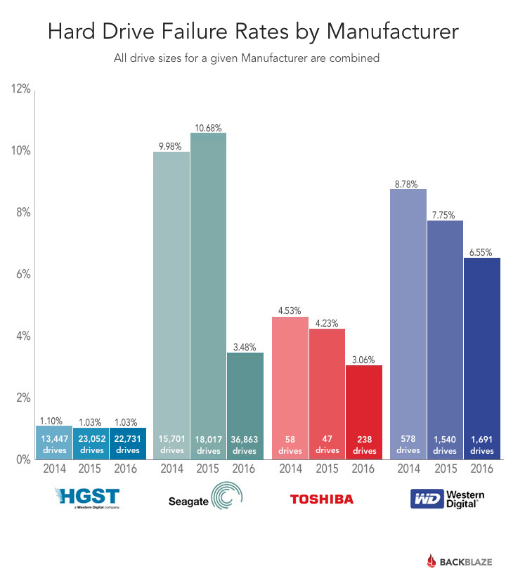

One of the problems I have with Backblaze's data is they tend to get the cheapest drives they can find, regardless of the intended usage scenario by these drives. That kinda skews the results versus if you get a desktop drive and use it in a desktop environment. Their PODs probably put far more stress than a typical desktop (or even SMB NAS), cooling and vibrations might also be an important factor.
My own professional experience with WD has been much better than Backblaze's own. Aside for various Caviar Green having issues when used in anything BUT a USB enclosure for nothing more intensive than daily backups, the failure rate I've seen on WD HDDs has been way lower than Backblaze's own numbers. My experience with Seagates however do match theirs, including with Seagate's SAS products (which Backblaze do not use).

Damn 100 is a pretty good sample from you, I guess I was just that unlucky lol. Seagate used to be good at one time. The consulting firm my father worked for, sent him to Seagate (over a decade ago) and at the time IBM consultants apparently convinced Seagate to cutdown backend testing as they figured the increase in failure rates and replacement costs would be offset by the money and time saved doing the testing. Low and behold you get what you have now. Interestingly enough IBM's former HDD division which is the Hitachi sub brand now owned by WD, actually has a pretty good reliability rate compared to its peers.
Aside for their infamous Deathstar (Deskstar GXP75 - I had two of these die on me at home within a period of maybe 1 year - one died within three days), IBM's HDDs were among the best at the time. Glad that the quality was maintained despite going through two new owners since then.
