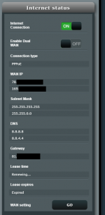

I've attached 3 screenshots. The last one shows 2 WAN IPs. I do not know why. The first one starting with 78 is my IP. I do not recognize the one starting with 169 (it seems to be a link local ip, why do i have that?) and I've no idea if that's normal. Also, there are 2 gateways.
