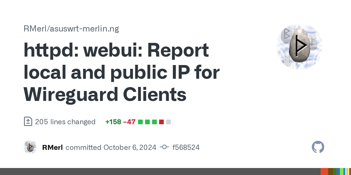

I thought this mod "Report local and public IP for Wireguard Clients" would be in this software.
