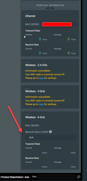

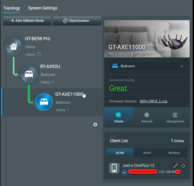

I may as well add my expierence here. I'm using a similar setup with AiMesh with a GT-BE98 Pro as the primary running Merlin 3006.102.1
Secondary is a GT-AXE11000 running Merlin 300.4.388.8_beta1 and it only ever connects using 5GHz with the wireless backhaul when I'm not using Ethernet. No matter how close the devices are to each other, and even if I select "6GHz First" from the AiMesh screen. It never respects or even attempts to connect to 6GHz.
Looking at the menu, it never even broadcasts the 6GHz radio on the AXE11000.
View attachment 60124View attachment 60125
Doing the little nvram trick to load the WebUI on the node to checkout the settings manually, I see this setup as the 6Ghz Network SSID:
Why is the 6GHz network on the node using the network SSID of the 5GHz network on the primary? it should it not be matching the 6GHz radio? And not the 5GHz radio?
Also noticed the _dwb at the end of the SSID for the wireless backhaul, even though it's set to use WAN currently as seen in the above photos. Trying to save gives me errors about the SSID being too long, even though AiMesh worked with the same SSID previously.
The nvram values on the node show no 6GHz SSID:
I tried using WL commands to manually enable the radio and set the SSID which worked, but devices still wont connect to the 6GHz radio.
I have MLO disabled and even tried disabling WiFi 7 on one of the 6GHz radios of the BE98 Pro to "match" the AXE11000's 6GHz radio, still the same issues of the radio not broadcasting and even enabling it with WL commands results in no devices connecting to it.

Edit: Funny enough, in comparison, my Gnuton AX92U so far seems to be working fine with it's dual AX 5GHz radios.
