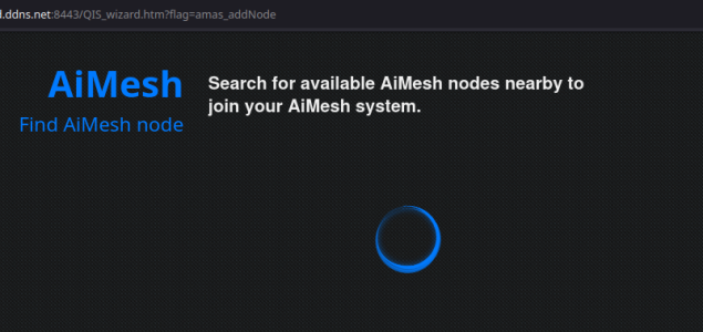

If it is an AiMesh node then depending on backhaul try AP mode or Repeater mode...
