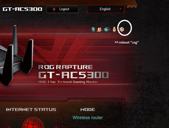

After checking things a bit further with rebooting using the Rapture UI - here's what I think is going on...
A "scheduled" reboot within the Rapture UI (my router is a GT-AC5300), seems to reboot both the router and all connected AiMesh nodes (works as expected). This is a good thing.
When manually clicking the reboot icon within the Rapture UI (shown in screenshot below), none of the Aimesh nodes reboot - they stay up, and the main router reconnects them after rebooting. If you SSH into any of the AiMesh nodes after a UI reboot, their uptime remains unchanged. If I'm rebooting the router from the UI, the connected AiMesh nodes should reboot as well, just my $0.02 on that.

Seems the only way to do that is to set up a scheduled reboot within the Rapture UI - Administration > System. The scheduled reboot definitely reboots the router and AiMesh nodes, the same should be true when manually rebooting from the UI (shown in the screenshot), but that's something ASUS would need to change, and who knows if that'll ever happen.
