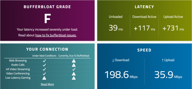

I have attached a screenshot of a bufferbloat test showing why I want to tweak my MTU settings. Based on ping tests that i have run, 1480 is the ideal packet size (including the 29 byte header info)

Everyone seems to want to change the WAN packet size. Gamers! When in fact you are shooting yourself in the foot as the packets get fragmented upstream anyway. Many feel bufferbloat is something to not worry about as well as idle ICMP Echo results (ping to you).
A system with good QOS may help. FIOS is way better than 5G (just can't understand why you would go to a network that pauses traffic to avoid collisions...WIFI is bad enough).
Bottom line? Don't mess with WAN packet size (and you can't use PPPoE anyway on a 5G network).

This 5G Internet will have fluctuating speed and latency depending on the tower load. You may never have good online gaming experience with mobile ISP. Don't waste your time with online bufferbloat testing. QoS on your end is unlikely to fix much. Just use what you have and don't stress yourself.

You can't just change to PPPoE. That is something you enable when your ISP requires it and that is somewhat rare nowadays.
1500 MTU is where you want to be, and that is the default anyway. You can change the WAN MTU without changing to PPPOE but you would not want to as it will almost certainly make things worse. You want it to match whatever your ISP is, which with 5G is typically 1500.
Ignore the buffer bloat garbage, that just means you're able to saturate your connection during a speed test.

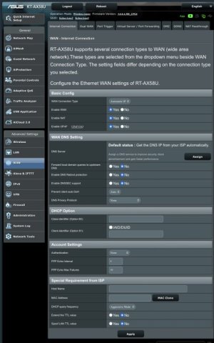

Does your router not have something like this at the bottom of the WAN settings?
Precisely correct. 1452 good, 1453 fragmented with the -f -l modifiers. So 1480. Absolutely only place in my AX86U where MTU an be set is under PPPOE tab.
Newer routers do not have the ability to change MTU. I believe my AC66U_B1 had it but not the AX86U or Pro version.
Odd, is it available in Merlin on those? I guess Asus assumes PMTUD is always going to work (when in reality it rarely does). Fragmentation is not the end of the world but certainly good to avoid it if you can.
Apparently so
If the firmware no longer allows it, you can change it via a script using ifconfig commands, but in reality it probably isn't going to impact you that much (if at all). Large transfers will have some packet fragmentation (which the router can handle) but in reality most stuff you do on the internet isn't using full sized packets. Path MTU discovery (PMTUD), when it works, will also prevent the fragmentation. When it works being the key phrase, though since the 1480 limit is one hop beyond your router, hopefully your ISP has it implemented correctly and it will work.
