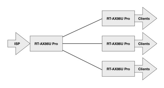

I am using 3 other AX86U Pro's in AP mode for the clients.

What is the RT-AX86U Pro connected to upstream?
