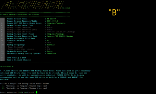

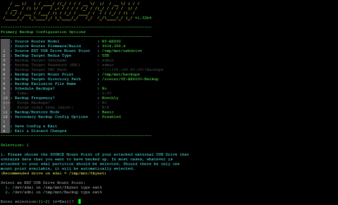

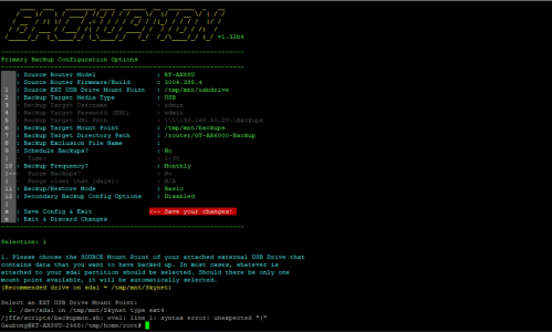

I have installed the script, but there maybe a small bug when configuring it 😁 Either selecting option 1 or 6, Backupmon shows a message of ["/jffs/scripts/backupmon.sh: eval: line 1: syntax error: unexpected "(" ] as in attached images. Then it exits automatically.
That's part of the intended function. It's called "exit out" when "error out". You should be happy because @Viktor Jaep saved you from breaking something with his "sh fail safe approach".
Thank you very much for your passionate work @Viktor Jaep!
Would you please run the following command on your router via SSH and post the output file?
Bash:
mount | grep "/dev/sd.* /tmp/mnt/.*" > $HOME/USB_MountPoints_DEBUG.txt
The error appears to be when looking for the USB drive mount points to build the menu options so I want to see what the router has mounted when the error happens.
Bash:

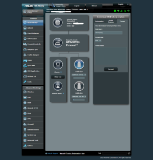

Thanks @Martinski. Here is the output result:
/dev/sda1 on /tmp/mnt/Skynet type ext4 (rw,nodev,relatime,data=ordered)
/dev/sdb1 on /tmp/mnt/Backup(1) type ext4 (rw,nodev,relatime,data=ordered)
By the way, my backup USB ext. flash drive used to be labeled "Backup". I have no idea why its name changes to "Backup(1)"
Edited to update: Interestingly, after reformatting and re-labelling the drive as "Backup", there is no more error message, and the output result is:
/dev/sdb1 on /tmp/mnt/Backup type ext4 (rw,nodev,relatime,data=ordered)
Thank you for providing all the info. Now I know where & what the problem is: the parentheses in the volume label "Backup(1)" were throwing up an error in the script "eval" line. I already have a fix for it so I'll be submitting a GitHub PR for @Viktor Jaep to merge into his latest code so we can avoid that type of error in the future.
In the meantime, yes removing the parentheses should avoid the problem.

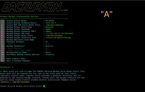

P/s: May I suggest that option 2 "Backup target media type" should be a prerequisite before changing other options so that future new users may not be confused again? Because if option 6 "Backup target mount point" is selected first, Backupmon only asks me to input the directory path (as shown in picture "A"). On the other hand, if option 2 is selected first, it allows me to choose which drive for target backup (as in picture "B").
Well, the intent is for people to go down the list from 1-12. If option 2 is selected for "Network", then the option 6 mount point question is a fill-in-the-blank, because it hasn't been created yet. If you chose USB, then option 6 uses the mount point selector, and lets you choose an already existing USB mount point. Obviously people can skip around in the menu and can practically do anything they want.
Thanks for this, @Martinski! Your changes were merged with the latest backupmon-1.32b4.sh file. Nice to know that this will no longer be a show stopper for others with unexpected characters in their drive labels. ;)
