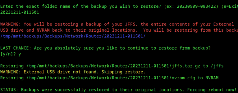

I have an interesting error showing it's face when restoring from a backup. Backupmon fails to restore my ssd. However, after the reboot if I run the restore again it takes. I can't figure it out, but at least there's a work-around. This happens with any backup, including with a backup from way back in September. I know, different firmware, but it's happening with backups from last week too.
I will point out that this is since a complete reinstall.
 Dec 17 2023 11:40:21 ripshod BACKUPMON[9418] - INFO: Successfully downloaded and installed BACKUPMON v1.40
 2 Dec 17 2023 11:40:51 ripshod BACKUPMON[9418] - INFO: Successfully wrote a new config file
 3 Dec 17 2023 11:41:05 ripshod BACKUPMON[9418] - WARNING: External drive mount point not set. Created under: /tmp/mnt/backups
 4 Dec 17 2023 11:41:08 ripshod BACKUPMON[9418] - INFO: External network drive ( \\10.0.0.15\storage ) mounted successfully under: /t>
 5 Dec 17 2023 11:41:50 ripshod BACKUPMON[9418] - INFO: Restoring /tmp/mnt/backups/Backups/Network/Router/20231211-011501/jffs.tar.gz>
 6 Dec 17 2023 11:42:03 ripshod BACKUPMON[9418] - WARNING: External USB drive not found. Skipping restore.
 7 Dec 17 2023 11:42:03 ripshod BACKUPMON[9418] - INFO: Restoring /tmp/mnt/backups/Backups/Network/Router/20231211-011501/nvram.cfg t>
 8 Dec 17 2023 11:42:04 ripshod BACKUPMON[9418] - INFO: Backups were successfully restored to their original locations. Forcing reboo>
 9 Dec 17 2023 11:46:01 ripshod BACKUPMON[17486] - WARNING: External drive mount point not set. Created under: /tmp/mnt/backups
10 Dec 17 2023 11:46:04 ripshod BACKUPMON[17486] - INFO: External network drive ( \\10.0.0.15\storage ) mounted successfully under: />
11 Dec 17 2023 11:46:24 ripshod BACKUPMON[17486] - INFO: Restoring /tmp/mnt/backups/Backups/Network/Router/20231211-011501/jffs.tar.g>
12 Dec 17 2023 11:46:40 ripshod BACKUPMON[17486] - INFO: Restoring /tmp/mnt/backups/Backups/Network/Router/20231211-011501/asus.tar.g>
13 Dec 17 2023 11:46:40 ripshod BACKUPMON[17486] - INFO: Restoring /tmp/mnt/backups/Backups/Network/Router/20231211-011501/nvram.cfg >
14 Dec 17 2023 11:46:41 ripshod BACKUPMON[17486] - INFO: Backups were successfully restored to their original locations. Forcing rebo>
100% repeatable on my setup - but I'm not testing any more.
That's strange... the part in the code where you are getting this is where it's trying to determine what your external drive label is... and if it's set to "NOTFOUND", then it skips the restore as in the error above.
How are you running the restore? Perhaps that will give more to go on... Are you running it from "backupmon -restore", or by going through the setup menu, or kicking off backupmon and hitting "X"?
I'm using "rs" from the Setup + Operations Menu, just as I always have done since this menu existed. It is a strange one. I understand a lot since I followed this scrip from it's birth, but this eludes me. Really strange as it recognises my ssd on the second run.
Edit: The only thing that has changed since my last successful restore is the addition of the SMB version in the config. I wonder.
I'll try tracing this and see if I can figure out why this might be... but definitely strange that it would work after a reboot! I'll also try another restore over the next few days as well to see if I can replicate this.

I have been tracing this and not coming up with anything solid... sorry, @Ripshod.
Ultimately, the script determined that you initially did not have a USB drive, and then after a reboot, it determined you did have a USB drive. I can't explain why. A reboot really should not matter in this case. Could the USB drive have been offline, and then came online after a reboot? Cable not plugged in all the way, then plugged in completely on reboot? No telling... I'm also assuming you left your USB drive label the same, and left it as "asus", correct? Did you format your USB drive when you did the complete wipe, and create a swapfile immediately afterwards, enable JFFS, etc. per the instructions? I'm assuming yes, since you do have quite a bit of familiarity with the script.
So the way I came up with determining if you have a USB drive or not, is by using this... feel free to run these statements one after another, and post your results below:
USBPRODUCT="$(nvram get usb_path1_product)"
echo $USBPRODUCT
USBPATH="$(nvram get usb_path1_fs_path0)"
echo $USBPATH
EXTLABEL="$(nvram get usb_path_"$USBPATH"_label)"
echo $EXTLABEL
If both the USBPATH and USBPRODUCT values are null, then it assigns a "NOTFOUND" to the USB label, and uses that throughout the script to exclude backing up or restoring from the USB drive, and only backs up/restores JFFS/NVRAM.
Determining whether someone has a valid USB drive has been tricky... if anyone has a better, safer and more reliable way of determining if someone has a legit USB drive plugged in, please do share your knowledge. ;)
EDIT: @Ripshod ... the only other thing that happened between prior-to-the-reboot and after-the-reboot is that you restored your NVRAM on that first round, then rebooted. I'm wondering if that put some settings back in place that made your USB drive visible to the script again?
